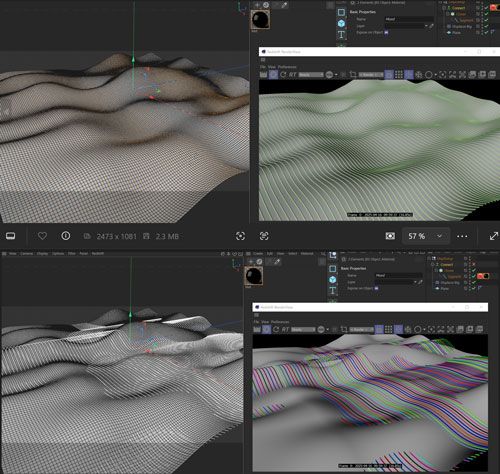

      Why are the cloned splines not matching with the same deformation of the plane?
      If I drop the spline-cloner into a connect it works as expected, but I loose the Indivitual clone IDs I need for the shading....😕
      splines4_small.jpg splines.c4d

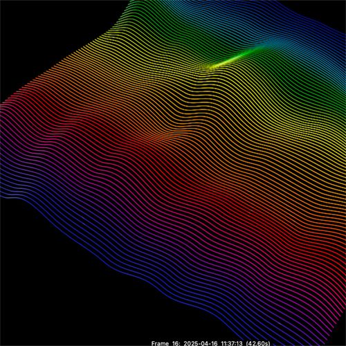

        Hi RemoGambacciani,
        Here is my workaround, with a Linear Field for the colorization.
        https://projectfiles.maxon.net/Cineversity_Forum_Support/2025_PROJECTS_DRS/20250416_CV4_2025_drs_25_RSvc_02.c4d.zip
        About the Splines and Deformation
        The deformation works with the point position relative to the Object axis.
        In other words, the points stay relatively close to the object axis if the object is moved.
