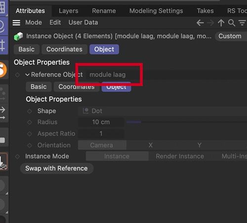

      I have an issue with Instances.
      All of a sudden my Reference Objetc is greyed out and I can not attach a new Object or change the Instance.

        Hi Dutchbird,
        Without a project file, I have to guess: Takes?
        A typical case of how that gets there: Did you load an FBX and allow Takes?
        Dutchbird 1 Reply Last reply Reply Quote
        • Dutchbird
          Dutchbird @Dr. Sassi last edited by
          @Dr-Sassi Grrrr. Takes again.
          Thanks.
