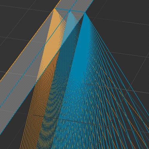

        The Container had some extra polygons inside.
