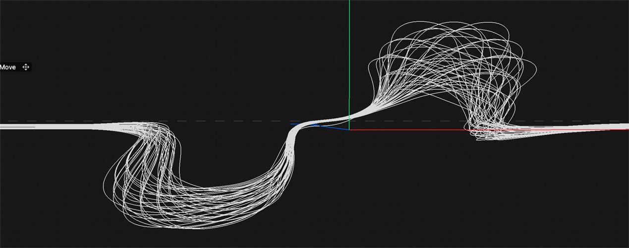

    Hi there,
    I have a question regarding a particle setup with a "follow spline object " and a tracer.
    So I created a setup where I have a simple spline, an emitter, a tracer, a follow spline object and a turbulence.
    Now I want to controll the start and endpoint size of the emittet particles so the"tubes" are always the same size at start and end.
    I have different visuals which are presented in a row, so the same height/position woulb be crucial for a seamless transition between them.
    Between the start and end point I would like to have variation in the different pictures, so I played with all the follow spline settings and turbulence. Setting the Emitter size really low helps of course, then I need the turbulence to break it up and spread it out. This results in the end point completly different than the start.
    Do you have an idea and could point me in a direction where to look closer?
    Thanks a ton!

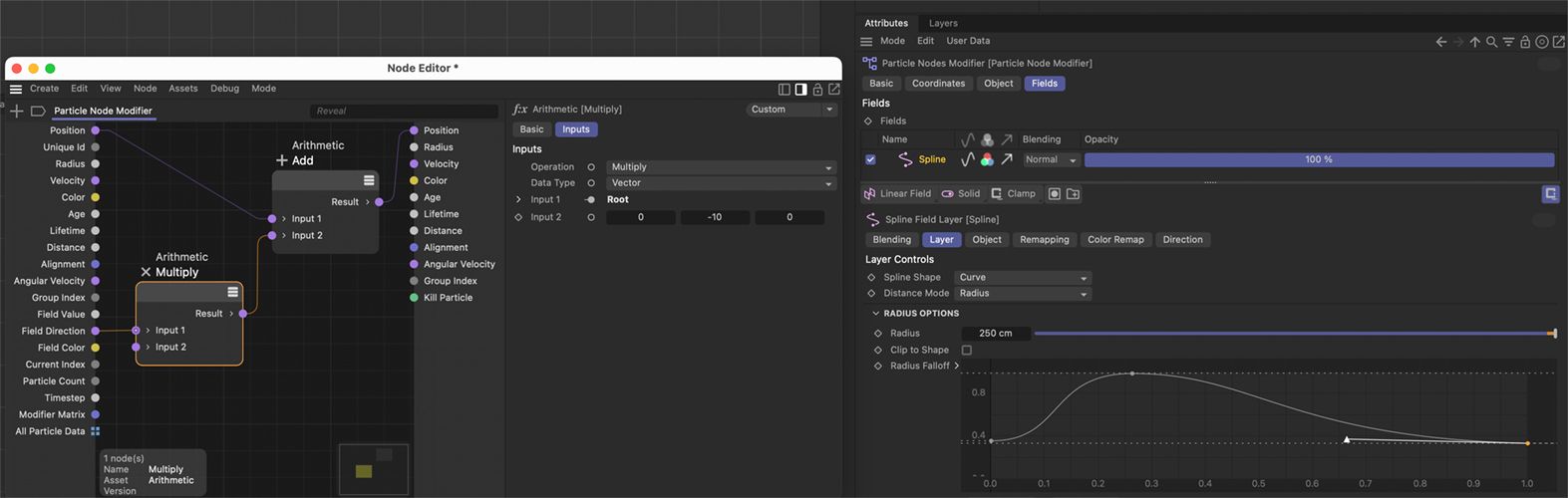

              Dr. Sassi last edited by Dr. Sassi 21 days ago 21 days ago
              P.S.: how about this?
              Using the main Spline as a Field and pulling particles toward it if they move too far out?
              The key parameters are the Radius and the Spline field, as well as the parameter of the Multiply Node.
              CV4_2025_drs_25_PAnm_01.c4d
              🔒 Log in to view

                      I believe there’s no need for camera mapping — the only things that really matter are the same size/radius and position at the start and end. Nothing more.
                      In the main file, I have 8 cameras with different images. I only uploaded one example since I assumed the specific image wasn’t relevant. The spline is duplicated for each setup, so the start and end points are always the same across all versions.
                      With the traced N-Side setup, this works perfectly — I can simply keyframe the size of the N-Side and match it at the end on the right. But as mentioned, it’s just not as smooth as the particle-based version.
                      So I guess that’s the deal: I have a working and okay-ish solution, but I’d really love to have the same level of control with the particle setup that I currently have with the N-Side.
                      To help visualize what I mean... That's all, just the same size at the start and end, as in this screenshot.
                      https://imgur.com/a/fsGjmGo
                      or here in dropbox
                      https://www.dropbox.com/t/kWFPcCW1OY134bBQ
                      Thanks again, and sorry for the troubles!
