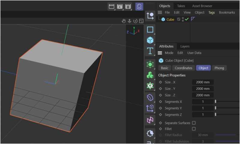

      Step 1: Open a new project with nothing in it, no materials or assets.

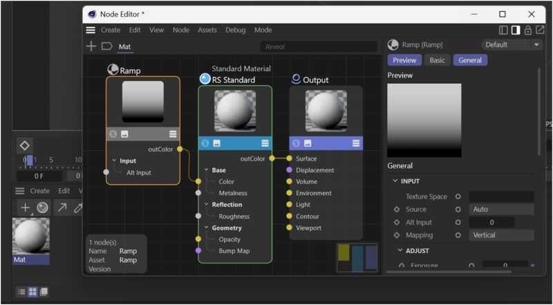

      Step 2: Create a simple redshift material, add a "Ramp" node, connect it to the color input.

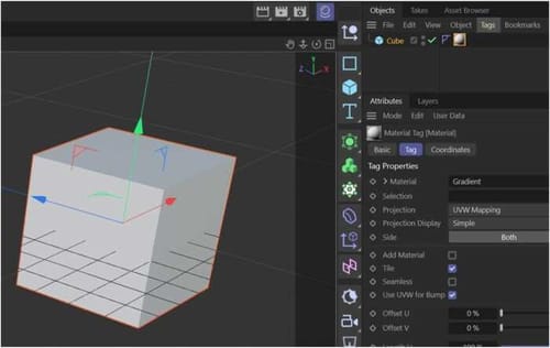

      Step 3: Drag the material onto the cube. Keep the default UV mapping.

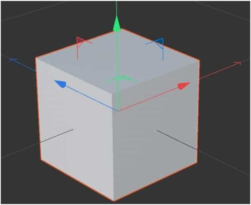

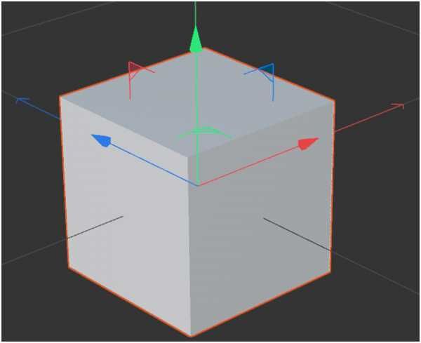

      The result looks like this:
      However, I would expect the cube to have the gradient showing on all sides, using these very basic default settings. I have played around a lot now with lots of different options. Things I've tried without any success:
