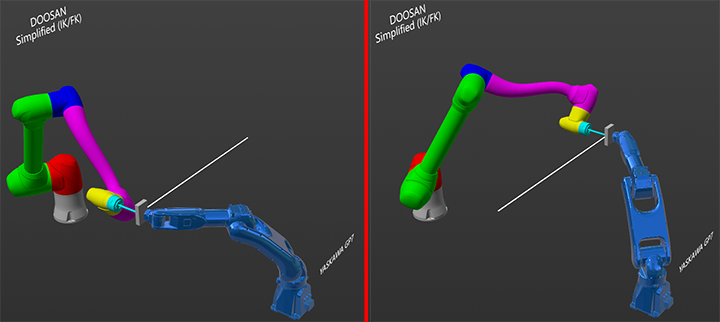

                  If you look at/click on the image below, hopefully it shows up big enough to illustrate what I am describing: the J4 (lavender) / J5 (yellow) / J6 (cyan) all have to coordinate their rotation if the EOAT is to maintain a locked orientation along a straight line. Even if I could get the positions dead on at either end of the move, the interpolated move in-between will not be along the straight line since a default spline within C4D is not the motion profile necessary on those joints to complete a linear move with the EOAT.
                  It seems to me that there is some kind of IK feedback loop which I am unable to replicate, because the IK-solution for J1/J2/J3 depends on the location of J4/J5/J6, but their orientation depends on the orientation of J1/J2/J3 ... so I have been chasing my tail! Part of my trouble is that I cannot seem to "push" anything with IK ... it is always a "follow-along" setup.
                  The blue robot is the YASKAWA GP7 I referenced earlier, which I did successfully rig up do this - I simply animated the position / rotation of the EOAT, and the intermediate 6-axes followed along beautifully based on IK and up constraints - but the catch is that here all the joints are in the same plane; the DOOSAN joints are all in slightly offset planes such that my method for the GP7 hasn't been working this time.
                  I hope that all makes sense! Again, thank you for taking the time to look at it. I can upload the file which is in the screenshot above, if that would be helpful - just send send me another Dropbox link.

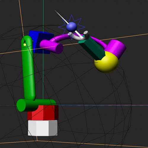

                                Since the head alone needs all axes of freedom to be positioned in any way (P.X, P.Y, P.Z, R.H., R.B, R.P), it creates a lot of stress on the "locked" axis down to the base of solved with dynamics. Which is similar to the problem with IK. I stick for now with my recommendation to invest the time in a good rig that allows for an easy adjustment with sliders or other HUD elements, meaning manual animation. The example I have shown with IK gets you there to a certain degree even.
                                My current idea is to reduce the complexity first, thinking of two spheres. One is centered around the base, and its radius is based on the second one. The second one gets its primary position from the first one while having the position freedom of the radius (the main IK arms of the robot)
                                Its orientation is based on a target that can be placed where the "head" needs to be. Similar to BB-8, but with a diameter-changing body.

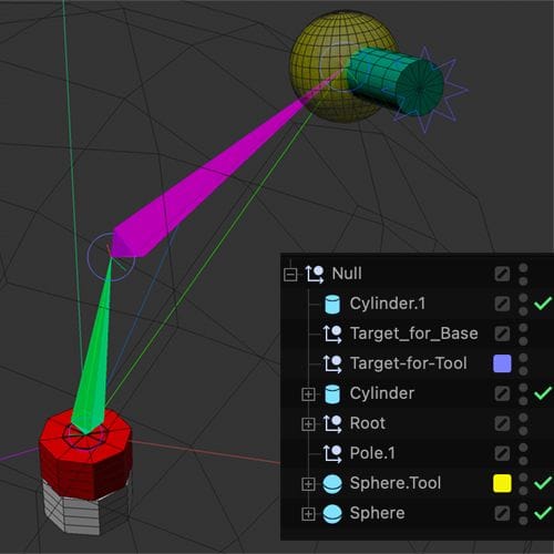

                                  P.S. Here is the BB-8 translation of the setup, as a source/collection of ideas.
                                  The Yellow sphere, can be positioned, while the Target_for_Tool defines the direction of the tool. Both have Layer colors applied to spot them quickly.
                                  File …_61 is static, with the two animated parts having a Position Freeze, so they can be reset with the PSR-Reset.
                                  CV4_2025_drs_25_CAsd_61.c4d
                                  File …_63 is filled with shapes, and yes, there is one short cut in it. Priorities are updated
                                  CV4_2025_drs_25_CAsd_63.c4d
                                  File …_64, just for fun, 240 frames and a longer animation
                                  CV4_2025_drs_25_CAsd_64.c4d

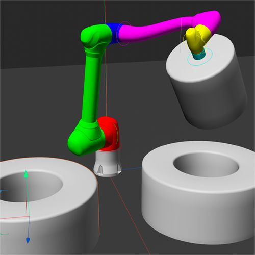

                                  Preview:
                                  https://projectfiles.maxon.net/Cineversity_Forum_Support/2025_CLIPS_DRS/20250621_CV4_2025_drs_25_CAsd_63.mp4
                                  As loop and longer
                                  https://projectfiles.maxon.net/Cineversity_Forum_Support/2025_CLIPS_DRS/20250621_CV4_2025_drs_25_CAsd_64.mp4
                                  The tool head will show an Euler angle problem if placed exactly vertically to the target.
                                  Here, the idea was to define a target and then just position the Yellow sphere (Keyframes only for Position).
                                  This allows for a tool axis movement, as seen between frames 100-120 in file 62.
                                  I found that here is the best compromise between IK and manual setup.
