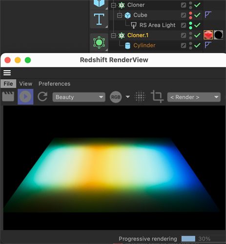

    I have a wave of Area light which I want to animate.
    I used it on a cloner with a Formula Field.
    It looks great in the viewport but when I render the animation I don't see what I wanted to achieve.
    gradient.c4d
    Cinema4D user since R8
      Dr. Sassi last edited by Dr. Sassi 22 days ago 23 days ago
      For everyone reading along: The set up was not the problem, the intensity was the problem. Set to one, all works

      Thanks for the file. Since you have problems, let explore some alternatives.
      Would this work for you? The intensity is inside the material:
      Emission> Weight.

      Ised here a polygon with Material Emmission Based on USer Data Color

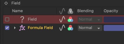

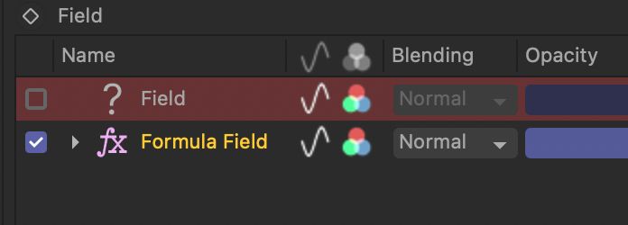

                    The interesting thing is that I can't reproduce that here, but I see a red-marked Field Object in your file that vanishes, and then I get an error. Metal Leak. So, I'm interested what is going on here.
                    login-to-view
                    Hence why I ask. More work on my side to figure that out.
                    I'm glad it works on your side.
