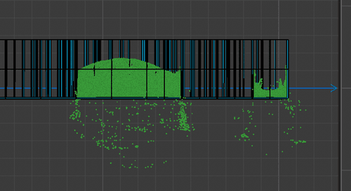

                Dr. Sassi, any idea what I have to do to have all particles colliding ? I have subdivided the collider polygons, have modified the nor of substeps, neighbours Passes, and Extra Iterations. Still the same
                  Hi Erwin (or do you prefer erwin)
                  I was just searching for a time trigger. As the Fluid Emitter has no animated Emission> Start Frame
                  Here is a sketch:
                  CV4_2025_drs_25_LImd_01.c4d
                  The Nyquist frequency. In short, if a particle is faster than the iteration, it is not seen.
                  Your file didn't have any fluid animation, so I reduced it.
                  What I found was that the receiving container had the normal direction to the outside, which might confuse setting up the Position in parameter settings
                  https://help.maxon.net/c4d/2025/en-us/Default.htm#html/COLLIDERTAG-ID_TAGPROPERTIES.html#COLLIDER_THICKNESS
                  I have set a larger value here to make a point; adjust it to your production settings, of course.
                  If something is not working as expected, check Normals, and set the Collider> Collision Sides accordingly.
                  Thanks for your file, and here it is back, reduced, to show more clearly what happens
                  CV4_2025_drs_25_LIfc_01.c4d
