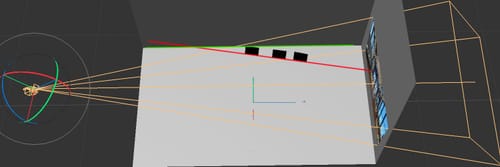

                  Out of curiosity, when you first opened the project I sent, what seemed to be wrong? Was the overall camera projection and position correct?
                  thanks!
                    Hi Alex,
                    When I look at the camera, it tells me ~85mm focal length. My value is ~21mm.
                    The lens was set to a shift lens with a maximum of 320%. My Canon TS-24mm (kind of a standard) allows for a shift of less than 100%, going by usable results. Hence my suspicion about the validity of the Offset/Shift.
                    The cube that describes the simplified cube of the space seems 90º based, so the cube is plausible. With this, and the cube considered correct, the windows need to sit on the Cube "Planes". They don't.
                    To "draw" or align from the camera perspective, with no cube alignment (in this case) provides no guidance where these windows might sit. It can even have different orientation, as the points of the four corners sit on a ray from the camera aligned with the window corner, while not providing any distance to the camera. Hence, the result can have infinite variations.
                    The image shows the mismatch between the image and the cube; compare the image above.
                    The complete image is projected to the opposite "Wall" including the content for the side walls.
                    The windows are aligned based on that on the red line that I included, and the green line should be the one used.
