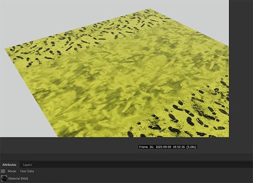

        Hi bet-beach,
        Please have a look here:
        https://projectfiles.maxon.net/Cineversity_Forum_Support/2025_PROJECTS_DRS/20250910_CV_2025_drs_25_ANsm_01.zip
        I would work with a very fine Noise to "diffuse the texture", here I used the colors first to set the texture apart, the noise can then move it in a way that diffuses it at the same time. Use the "Redshift Render View" and press play.
        Check the values in the Distorter, to get more or less effect.
        Perhaps you like to have the initial state undistorted and work with colored noise. Explore what fits best with your idea.
        Please know, for security reasons, I touch only a few standard cloud services (WeTransfer, Dropbox, Google, Apple, and Adobe), hence I worked from your image only.
        Please let me know if there are any questions. I'm happy to look into those.
        Enjoy

            Hi bet-beach,
            Yes, Cinema 4D is very flexible and versatile. Thank you for that.
            Thanks for the Google files.
            The UV-based movement (Distorter) can only push a single pixel in x or y (red or green), or just gray values, and then based on the distorter's global settings. To follow a brushstroke while the brush is rotated means to put the image on the head at one point, which might be possible, but I assume it would take a lot of developing time
            https://help.maxon.net/c4d/2025/en-us/Default.htm#html/COM_REDSHIFT3D_REDSHIFT4C4D_NODES_CORE_DISTORTER-COM_REDSHIFT3D_REDSHIFT4C4D_NODES_CORE_DISTORTER_GROUP_0.html#COM_REDSHIFT3D_REDSHIFT4C4D_NODES_CORE_DISTORTER_INTYPE
            Perhaps I miss something, as ideas often come with a new problem, but here I'm not clear how to follow that brush in any direction, what rotating (or broom in your video)
            I found it easier to explore particles here, as that is what comes closest to dirt. Here are two sketches.
            CV4_2025_drs_25_PAcm_01.c4d
            CV4_2025_drs_25_PAcm_02.c4d
            The Delay needs more attention.
            The other way would be to set the animation brush (or broom) and render it from top view. Then "smear" in Photoshop along the path. If the brush crosses its own path, the next image is needed, based on the one just smeared (Smear Finger, 80-90%). Those images are then layered and unveiled with a vertex map, set decay to 100%, meaning nothing decays.
            I hope that helps for your next meeting.
            My best wishes

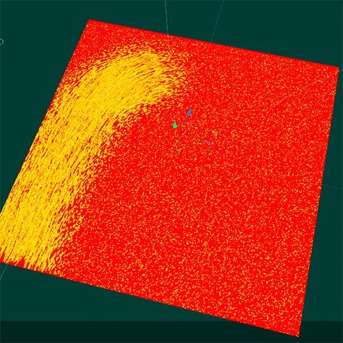

              Hi bet-beach,
              The Smear-Finger idea (Photoshop) was nagging me to translate that to Cinema 4D.
              The simple idea is to run a Wind object along a spline and add some other parts to it. Done.
              Example:
              CV4_2025_drs_25_PAcm_21.c4d
              Yes, it follows the direction even around 180º+ movement.
              One more, if particles have moved a certain distance, they go into the Group.2, which means they can be used for additional "effects".
              CV4_2025_drs_25_PAcm_22.c4d
