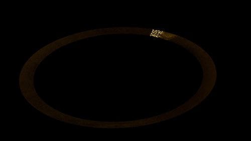

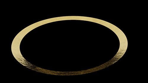

          We are still having a problem with the lighting issue. When I first opened your project and rendered the rim in the Redshift RenderView window, the lighting issue seemed to be resolved. But the next time we rendered it and ever since, the light issue reoccured. Please see the attached images showing what we are seeing here.
          We need the rim to be consistently lit as the Poly FX wipe on.
          Rim lit before Poly FX wipe animation starts.
          1st frame of Poly FX animation: the rim goes dark where the Poly FX are not yet triggered.
            Hi Mark,
            Please have a look here:
            https://projectfiles.maxon.net/Cineversity_Forum_Support/2025_PROJECTS_DRS/20250914_CV4_2026_drs_25_MGpf_02.c4d.zip
            I have tossed out the Triplanar, as it should not be used with changing Polygons. Here, especially with Normal maps.
            I have connected the Scale as well.
            Place the file in the folder of your project, so the texture connects if you are offline. Since this material was an Asset Browser, if the path had been left as it was, the textures would have been used from the Asset Browser.
            Normal maps have XYZ Normal information stored in them, expressed in Linear RGB, or RAW - meaning numbers are used as found in the file (No gamut mapping or gamma adjustments, etc.
            If they are placed into a Triplanar, they mix on the "cube projection edges", which equals a mixing of XYZ. To name one example. They are not connected to any UV(W), and so any object change will also change the parts used.
            More about it:
            https://help.maxon.net/c4d/2025/en-us/Default.htm#html/MMATERIAL-ID_MATERIALGROUP_NORMAL.html?TocPath=Material%2520Manager%257CClassic%2520Materials%257CClassic%2520standard%2520material%257C_____13
            The change of the Scale in those was huge, perhaps an Arti's call, but that is way more than any texture might be able to supply and stay useful.
            If you need to keep going with the material, place a Connect Object as parent, switch off the Weld check box.) I haven't tested all view angles, but it helps. Again, as mentioned before, the material has no qualities for animated objects. The CV4 version of it does.
            The problem-solving strategy here was to use the white material and compare the results. If the problems had existed even with the simplest material, other sources might have caused it. I left it as a hint for that search.
            As a side note: (going by the edu version used here), the problem doesn't show up in 2026.0, but in 2025.3.3. So it might be arguable what the cause is here.
            For now, I have offered two ways to solve it, while also two ways to explore it, light and material change. I'm a firm believer that problem-solving strategies are a good portion of becoming fluent in 3D content creation. I hope these two options help in the future. /end of side note
