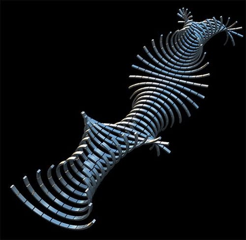

      At my company we’ve been trying, without success, to create a path using 11 rectangles.
      As you can see in the Cinema file I attached, the rectangles move forward, and with the bend you get something like a bird-flying effect.
      What we want to achieve is for each square to generate geometry, like an extrusion. As the splines move forward, the geometry should appear behind them.
      We tried creating a Connect object, placing the group inside it, and then extruding everything, but that made us lose the trail effect of the wings.
      Here’s a real-life example:
      alt text
      I am using Cinema 4D 2024.4.0
      Thank you so so much! I hope you could find the solution ( I know you will 🙂 )

          @Dr-Sassi Thank you for your amazingly fast reply to my post. Since English is not my first language, I couldn’t explain exactly what we needed.
          Right now we only have pieces, but my idea is to create 11 single strokes
          alt text
          The idea is something like the image.
          That's why I tried to animate the shapes, to see if I could extrude something and make the recently extruded parts remain static

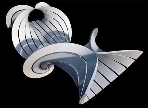

              Here’s another image to illustrate my explanation.
              alt text
              On the right is as far as I got; on the left you can see exactly why I want to extrude.
              The difference lies in the orientation of the squares: on the right the squares always face the Y axis, while on the left the squares rotate naturally — and I need that natural rotation.
              Is this possible in Cinema 4D? It looks so simple, but my team and I can’t find the solution.
              You are our only hope, Dr. Sassi and thank you for our time!

                Now I understand the Extrude; not just the Spline extrude to give it a static shape, but also to draw a line.
                Example:
                CV4_2026_drs_25_MGmw_05.c4d
                The Tracer is set "from end" with a length of 24 frames; more frames result in a longer tail, while fewer frames result in a shorter one.

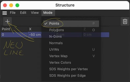

                    This is done with two identical settings. The information (Clone) for the Tracer is simply a Main Menu > Create > Polygon > Empty Polygon.
                    With the Main Menu> Window> Structure Manager> (Point Mode). Add one line to it and set the point to 50cm in X, for the other Polygon "-50cm" in X.
                    This single point in each setup is now moved based on the setup under 1.
                    With the help of each "Tracer.Main" and "Tracer.Rail", a Spline is created to feed the Sweep, while the profile is just a Spline-Line object. The Rail Scale of the Sweep determines the size (hence the Polygon 50cm or -50cm defines the size here).
