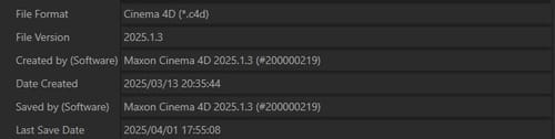

      Here is the info screengrab of the last version os the scene that worked/rendered OK:

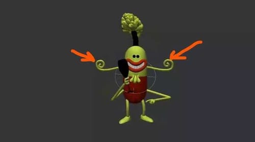

      Notice the teniticles movement, they are dynamic in 2024 and rigid in newer versions of C4D:
      Here is the video preview of how character tentacles should move:
      https://youtu.be/0gE5SDUVC34

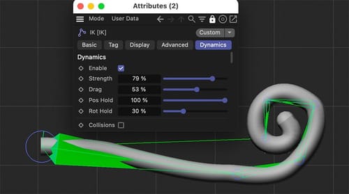

        You asked for an alternative: I explored the use of Joints and IK, set to Dynamic, but it might come close, but not a match.
        Example sketch:

          Anyway, here is a refined Joint Dynamic version
