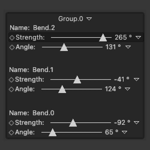

        The first option is to select the parameter in question, Right Mouse Click (RMC) on it, and choose from the "fly out menu" the "Add to HUD". This places a copy of the parameter into the editor.
        While this can show up only when the object is active, it is possible to RMC on the new HUD in the editor and choose Show> Always.
        Then add more. You might select all objects with thesame parameters, then select each object, while the parameter selection stays active. Perhaps ad the Object Name to HUD as well.
        To move them around, a CMD+ click allows you to move those.
        After they are set up in the way you need them, you can Shift+Click select them, and CMD+Click combine those to a Group.

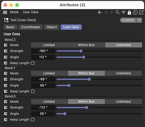

          I already had them on the HUD, and that’s of course one way, but I know I’ve seen someone who had all those sliders in a separate floating window, could that be Xpresso?
          Is it very difficult to make?

            The main idea is to create input options that produce a value that can be fed into the parameters of the object. It is just connecting the interface input options to another one.
            The transfer is always via XPresso. The input option can be accessed with a simple node, the one that represents the object. It can be done from "sender" to "receiver" (two nodes) or has a Range Mapper between two to translate the data as needed (three nodes). Of course, no rule limits that to 2 or 3 nodes. You could put some other nodes between, but we're already ahead of the core idea.
            However, the Range Mapper might need a word: Mapping means here you could turn 0-100% from the sender into 0-360º for the receiver, or -45ºto45º for the receiver.
            If you have a few minutes to explore, you might even like it a lot. The clip below is not a tutorial; it should just give you an impression of how it is set up.
            https://projectfiles.maxon.net/Cineversity_Forum_Support/2025_CLIPS_DRS/20251115_UserData.mp4
            If you like to own that skillset, explore it, and please mess around with it, as that fills your creative library and you might come up with very useful ideas for your projects.

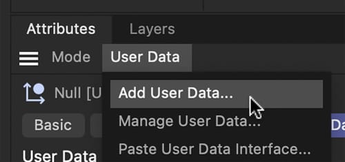

            The first step is to get an object that has in the Attribute Manager the User Data option. Then define what the receiver needs. If it is the same value/data, then no Range mapper is needed.

            The type of data you like to create for this "Mixer" can be either set up manually, or with simple Set Deriver, Set Driven commands, which will produce, each time, a new XPresso Tag, which is good for a few, but for many, do it manually.
            I hope that allows you to start to explore this theme, as it is quite a large toolkit to create your very own Mixer.
