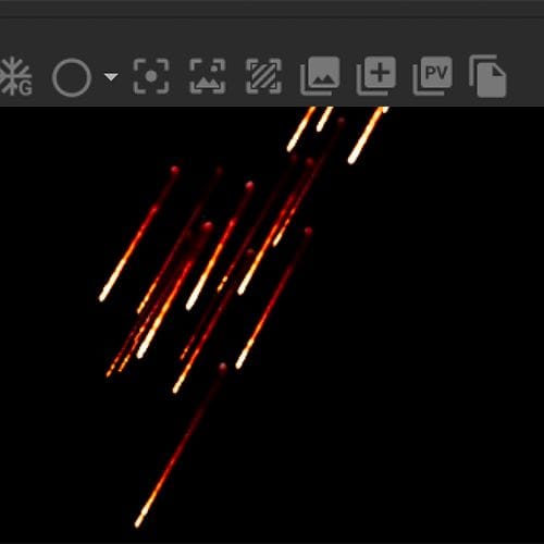

      Pyro won't render. I've tried using a pyro material and a volume material. I've cached the scene, etc. Here's the link to the project file.

        Start at frame zero, stop perhaps at frame 20, and render.
        I have swapped out the Pyro Output, the material, and deleted the Scene Object (it was empty).
        Is that rendering for you in that way?
        Please let me know.

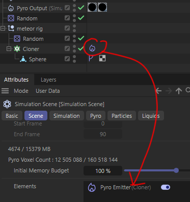

          The reason it's not rendering is that you haven't included the Pyro Emitter Tag into the "Simulation Scene" Elements. The simplest solution is to Drag the Cloner's Pyro Tag into the "Elements" Box and rerun the simulation.
          Step by step:
          1. Rewind, delete and disable caches
          2. Select "Simulation Scene" Object and go to "Scene Tab"
          3. Drag the Pyro Tag (NOT THE OBJECT) into the "Elements" Box
          I had to decrease the sim resolution as my GPU can't handle it, but it did render.
          PyroWontRender-1 Fixed.c4d
