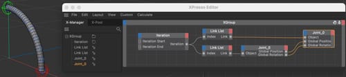

        I have experimented a little bit, while keeping the shown results of the video in mind as a target. Like Align to Spline or another option.
        Of course, I have to mention that Cinema 4D has the Toon character set up. Which is surely the fastest way to get a very complex, yet easy to animate rig in the "pipeline".
        Below is, in my opinion, the fastest way, especially if you have huge numbers of those.
        The one joint (bone can be set into many with the shift click "split" function. Convert them into null can be done, but is perhaps not needed. In the example I have done it, to follow the question.)
        The transfer is then done with a simple iteration XPresso setup.
        To get many Single Joints, CMD drag one, select the two, CMD drag these, select the four, etc. In no time, you have a lot.
        Joints and Nulls each go into the Link List, and both get connected to an Itteration. If you have nine joint objects, then the iteration is 0-8.
        Drag one joint and one Null into the XPress editor; they serve as "Receiving Container", and get via iteration>Link Linst all Objects sequentially as output.
        Transfer the Global Position and Global Rotation to it, if you like to adjust the Scale of the Joint. Other wise the Global Matrix does the trick with one connection between the Nodes.
        I have frozen the Coordinates of each object, so if a reset is needed, use the Reset PSR function.

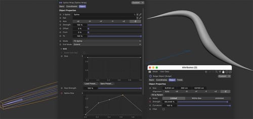

            Here is an example with an PLA animated spline.
            CV4_2026_drs_25_CAsw_01.c4d
            Here I use the Spline Wrap
            The object stays in place โ€œvirtuallyโ€, and can so easily be changed with "local" Deformers, like the Bulge.
            The Splinewrap (I have its bounding box fixed here) can easily change the shape with its integrated Spline Interface Adjustment: Size and Rotation.
            If the single Spline set up creates some trouble, a Raid Spline can be used, but of course, that increases the complexity.
            I'm sure there are more ways, but each character setup might need something else.
