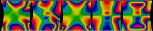

                Heatmap of the Vertex map influences

                        From the time stamp based image of the tutorial (I did not watch it -one hour…, after all, the first two weeks of ‘26 I have time off), but I wanted to share this with you. Take it as a sketch.
                        You asked about the Balloon while also having Animation running. (One Bag is animated)
                        Example
                        CV4_2026_drs_26_SIcb_51.c4d
                        Enjoy

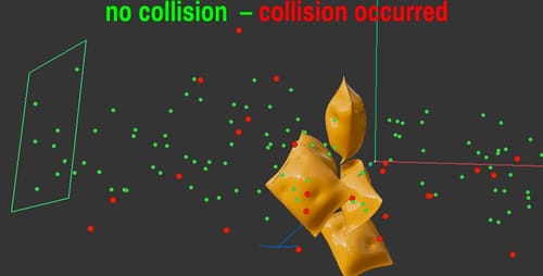

                              As long as we're talking about this shot, maybe you can answer one extra nagging question. I have the bags animated in a way I like now, and I wanted to add some particles that are being thrown at the bag and have the bag interact with them. Now, I tried these two ways, and both failed. First, I tried adding a rigid body tag to the cached softbody object...didn't work. Then I tried baking off an alembic file, then added the rigid body tag to that, and it killed the baked animation. Doing some research, I did find an older article saying to use the "use animation" checkbox. But seems the new tags don't have that option. I'm at a loss. What is the correct tag set up for having an animated Alembic file act as a collision object?
                              I didn't upload a file, as this seems more of a "check this off" type of thing. If needed, I can, though.
                                Hi PlatPlat,
                                Your description is, the bags are cached, and the particles need to react to them. To be clear, anything that is cached will not get new deformations (softbody-wise) from new collisions.
                                Have you added the Collision from the Particle Menu as well?
                                The project file …_61.c4d is a simplified setup. The …71.c4d is an updated from the 51.
                                The bounced Particles go into a new group, not needed, but to showcase which one bounced.
                                If you have to re-cache the bags, switch the Collider tags off for the time of caching.
                                Examples
                                https://projectfiles.maxon.net/Cineversity_Forum_Support/2026_PROJECTS_DRS/20260109_CV4_2026_drs_26_SIcb_61-71.zip
