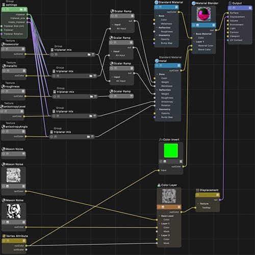

              Thank you again. I have taken your RS Mix material, and added it to my project. Using the RS Mix, I am getting the same drop-out of the displacement in random frames. I have only one field driving the vertex map for the swapping materials. Both of the noise patterns in the galvanized gold are animating.
              I uploaded the complete project to the folder I shared before. Here is a direct link to the subfolder which has the RS Mix swapper in use.
              https://drive.google.com/drive/folders/1gopgnSQw0yOK3d0RzFCTklcmL02cf4sT?usp=drive_link

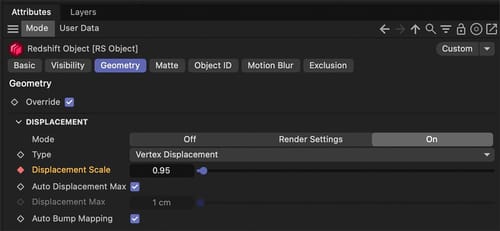

                        Now I went to the RS Render Tag, and animated the Displacement Scale from frame 0 with a value of 1.05 to frame 90 and a value of 0.95. The change is nearly invisible, but the number change means that a new displacement case is needed, a “refreshing-problem” would be my best guess for now.
                        Rendered it three times to see if any of the random drop-outs appear. All fine.
                        I get no "displacement drop-outs " anymore. Can you confirm that?~~
