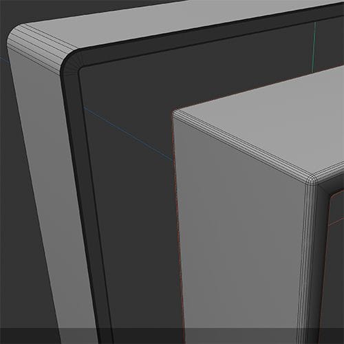

                That means you need to get the Caps to the side where you need them, like with the Extrude:
                CV4_2026_drs_26_MOpf_01.c4d

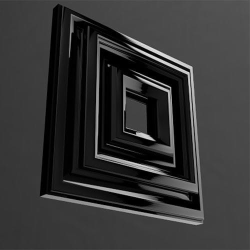

                Or just use the setup of yours with the two rectangle Spline and add to the Profile a quick Spline-Sketch
                CV4_2026_drs_26_MOpf_11.c4d
                Is this working for you?
                  smckenzie last edited by
                  Didn't think of the Spline Mask. That's super helpful, thank you!
