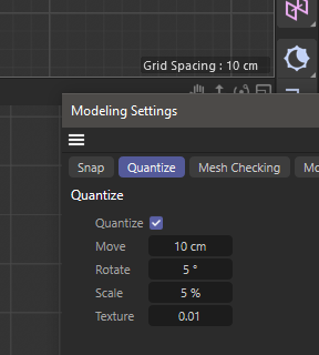

      Stupid question. But how can I set my grid spacing. Can't find it anywhere.
      I used it a lot and now I am into a project where I need it.

        @Dutchbird
        It's a bit "hidden".
        Go to the "Model Settings" (Snapping, Quantizing, mesh check etc) and Activate the Quantizing.
        The "Move" Value is the Grid Size 🙂

          @noseman Thanks a lot. That was an answer at Dr.Sassi speed.
          I thought it had to do with the Quantize thing but it is totally different as in the past, years ago.
