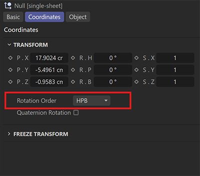

      is there option to set default Rotation Order from HPB to XYZ?

        no option as far as I know, but you could save each object type as a preset with XYZ selected.
        Here's how to do it:
        1. Add a cube, or a mesh object or any other type of object in your scene.
        2. Set Order to XYZ
        3. Right Click on "Rotation Order" and "Save Selected As Preet..."
        4. Name it appropriately
        5. Find that preset in your Asset Browser and add it to your UI or a palette.
        6. Save your layout or palette
        From now on you can select any of the presets instead of the default objects.
        You could also make your custom layout with your new objects instead of the default ones.
