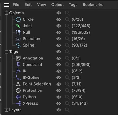

                Hi DjeisonCanuto,
                Please keep in mind that the Advanced Rig contains three different Joint Rigs, the FK, the IK, and the Binding one, while all are in some or other way connected to the Controllers. The Mixamo rig has more parts to make that connection happen. I see here a reason why you find no tutorials about running the Advanced Rig with Mixamo data or similar data sets.
                In the image below, it is easy to see how they differ; the selected numbers (on the left) are the ones from the Mixamo rig. The Numbers on the right are from both while set up with comparable features.
                Compare the XPresso and Python numbers, here is the main difference.
                Here is the set up, see for yourself.
                https://projectfiles.maxon.net/Cineversity_Forum_Support/2025_PROJECTS_DRS/20250715_CV4_2025_drs_25_CAam_01.c4d.zip
                It is not absurd, it is based on that it is a lot of work, while the amount of requests are slim to none. (AFAIK)
                Please request this via the "Share your ideas".
