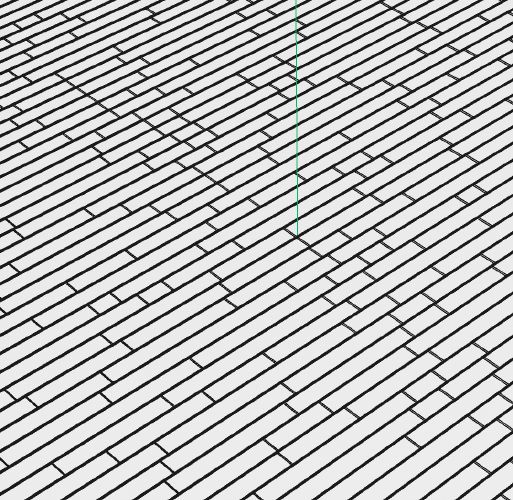

      Suppose I want to create a floor from individual cubes, representing flooring planks, where the width and height of the cubes is the same but they vary in length, say 10cm, 2cm, [30, 50, 70, 100cm] (x,y,z).
      How could I distribute these in a procedural manner so that the different lengths appeared randomly and the cubes were all snugged together and oriented along their z-axis?
      I've tried Cloners with various Effectors (Random and Push Apart), the Distribution nodes in the Scene Node editor, Fracture Object, and a few others.
      Thanks,
      Greg
        Hi Greg,
        There is no default option for this.
        It needs some work to create (minutes), but then you can have a wide variety.
        First, set up a standard board and clone it ten times in a row.
        Current State to Clone, then Connect and delete.
        Create copies from it. Move the neighbor points in the line direction.
        I created each line of ten boards differently. I used the Rectangle Selection for it and then moved the points.
        Check out the files Cube 0.0 to Cube 0.4, which are individual versions. Cube 0.5 to Cube0.9 are copies.
        This goes under Cloner, set to Blend, on Clone (yes, just one. This gets the Random Effector, Noise, and Modify Clones, Uncheck Position (Parameters)
        The Single Clone Cloner is then a child of the Cloner that sets the long "Ten Tile" lines as an entire floor.
        The Random Effector will not blend between them, so the dimensions are each time different.
        Explore the Effector Tab section of the Random Effector in the file.
        Materials can be set via Selection Tags. Typically, they don't blend, but that is another theme.
        … and yes, real random leads sometimes lined up boards. Never matching an edge is not full random 😉
        https://stcineversityprod02.blob.core.windows.net/$web/Cineversity_Forum_Support/2024_PROJECTS_DRS/20240228_CV4_2024_drs_24_MGfl_02.c4d.zip
