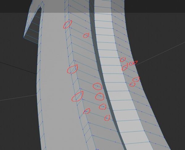

      How can I easily remove the unused points and strange cuts in a model.
      The Optimize tools doesn't work for me.
      I have to get rid of a lot of point which will mess up the Surface subdivision.

        Hi Dutchbird,
        Thanks for the image.
        Some techniques might not work, so test this on a copy.
        The points on a straight edge: (Enable it, Check Mesh X)
        Go to the Attribute Manager> Mode> Modeling> Mesh Checking
        Use the Edge Points there, twirl the triangle open, and check if 170º (the default) is working for you. Then, select the Points (>>) and delete them.
        Edges with no flow along the mesh, the brut force would be:
        Main Menu> Mesh> N-Gons> Remove N-Gons.
        My tip: Try Remesh first. It is in the Generator Menu, the one with the SubDivision Surface Icon (Green) as the top icon.
        Perhaps set the Remesh to 50% and try other parameters. Allow for a moment to calculate.
        Explore the Mesh> Remove entries, like Dissolve, for manual clean up.

          Wow. Thanks a lot Dr.Sassi. As always a more then satisfying answer. I was able to clean up and create a smooth model.
