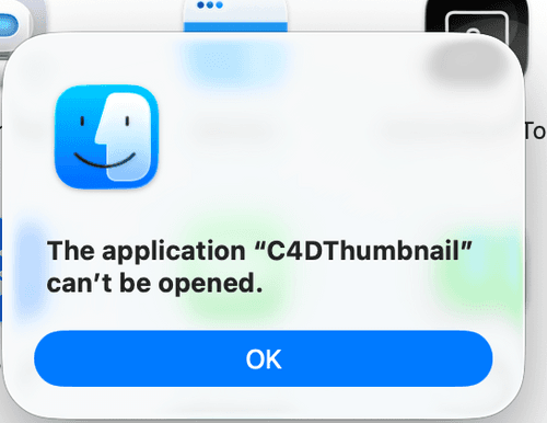

                            @Tisi Thanks a lot for preparing. Unfortunately I can't even open the app on my Mac (Tahoe, M4). Apps are allowed from anywhere and I also tried some permission things in the terminal.

                                But unfortunately no C4D Thumbs are showing. Cleared cache already etc. What could be the problem?
                                This is showing when I click now on the installed app:
                                E 1 Reply Last reply Reply Quote

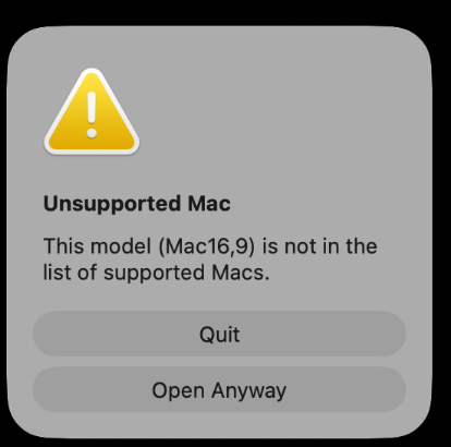

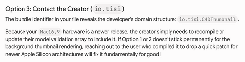

                                    Unfortunately I think either the Mac or the OS is not supported
                                    This I get on restart:
                                    On what Mac / OS did you got it to work?
                                    It's installed and I see it in the extensions. But no thumbnail no matter what I do.

                                        I did a lot of Claude/Gemini things also everything listed above, nothing worked and on startup it still shows my Mac is unsupported. If you find time @Tisi, maybe you can adjust the code to include all Mac models 🙂
