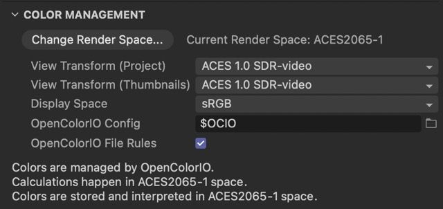

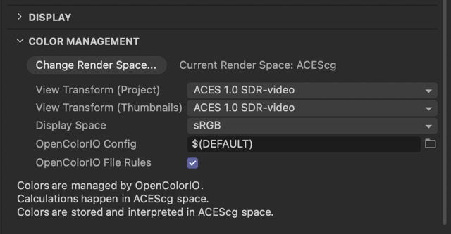

      I noticed different settings in the Color Management.
      It came up like this.
      But it has to be this.
      I deleted the new.c4d default scene and the preference folder and it all looked like it has to be.
      After a while and a new startup of the Application the settings are wrong again.

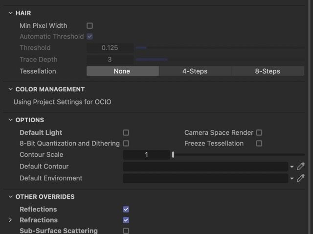

        I also notised my Color Management drop down in Redshift Render settings is gone.

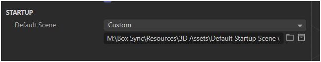

          I had some weird color management issues with redshift initially, but set these settings on my default project and it's been ok since. I have a default project that opens up whenever I create a new project in C4D.
          You can change the default startup project by going to Edit > Preferences > Files and amending the settings here:
          Dutchbird 1 Reply Last reply Reply Quote
