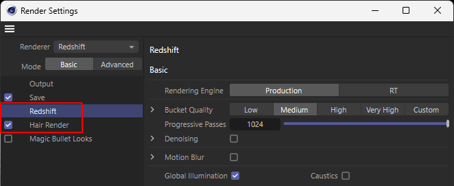

                • C
                  Cit last edited by
                  Hi!
                  Maxon Support just got back to me — super quick response, fantastic.
                  They’re aware of the bug, and in the meantime, it seems that simply changing the order in the Render Settings should do the trick. Just place “Redshift” above “Hair Render.”
                  I’m in the middle of a project right now, so I’d rather not test it until I’m done, but that should work.
                    Hi Cit, thank so much for sharing this.
                    Works for me.
                    My best wishes for your project!
