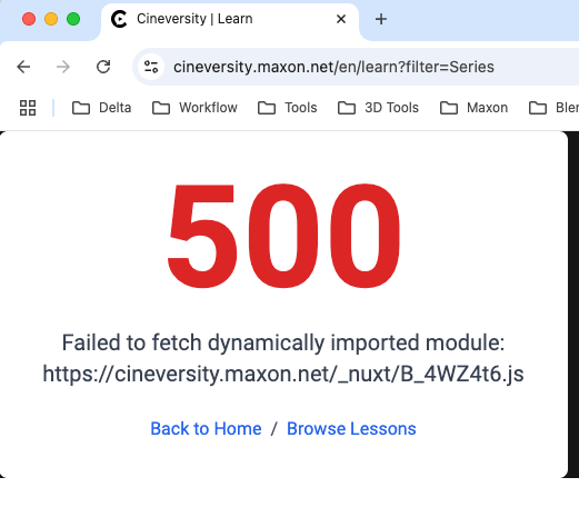

    I cannot get Cineversity to load any sub pages on several networks here in the USA. For more than 15 days, the issue happens at the school’s AT&T network as well as TMobile WiFi or cellular or at several locations. I was able to get it to work when connected to a Spectrum ISP network.
    Chrome and Safari report an error:
    500 Failed to fetch dynamically imported module: https://cineversity.maxon.net/_nuxt/B_4WZ4t6.js
    or
    500
    'application/octet-stream' is not a valid JavaScript MIME type.
    Although Maxon support says it is on my end, 500 errors are on the server side.
    After inspecting the site with Chrome Dev Tools,
    The error message inside Chrome points to a Content Security Policy directive set to "script-src 'none'"
    This causes the nuxt.js generated script (and subsequent scripts), CyjJQS-n.js, to not load and the site to fail to load on any browser which enforces CSP directives, such as Chrome or my Safari.
    I believe it may be the CDN Maxon uses in my area, because if I change my geo location to Germany, the site opens fine.
    I know this problem exists.
    I know the issue is outside of my control.
    If anyone can help, can you reach out?

                    Hey CSpill, I am the one who reported it. I am in the southeast USA. Please pass on as much of your situation to the support staff at Maxon. Perhaps if they discover others who have reported the issue, they can narrow it down. I have been getting help, but it still hasn’t worked completely.
                    I did find a work-around. If I use the Firefox web browser, the site loads fine. I have many theories, and have shared them with support, so hopefully they will be able to figure it out.
                    Try Firefox, it may work in the meantime.

                                    Same issue here in Birminham, Alabama. I can't access Cineversity from my office or home. I submitted a customer support ticket and followed their suggestions: Deleted Cached files and history (Chrome), tried using Microsoft Edge, tried using my Mobile, to no avail. I installed Firefox and the issue was resolved. I hope this helps to narrow down the culprit.
