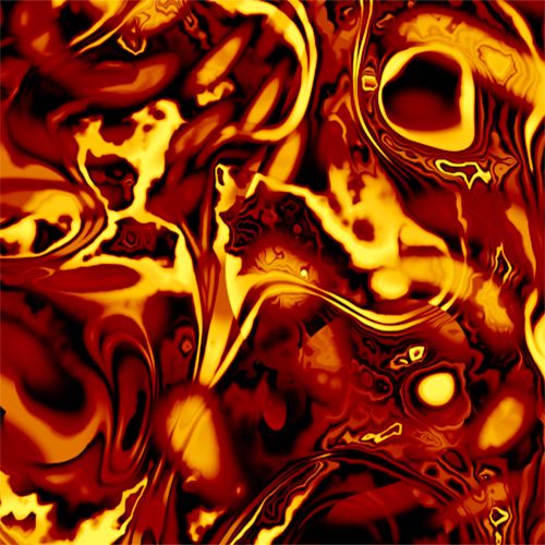

      I am trying to simulate below picture / animation.
      It is a simulation of fluids mixing (often used in light show at pop concerts).
      So the main thing is how to 'mix' textures in cinema?

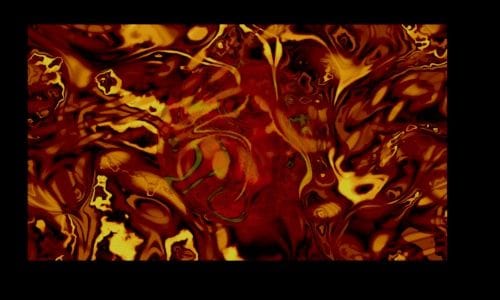

      I started using the Proximal shader, but it is very complicated.

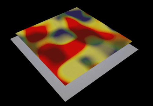

        Here is a starting point. Explore how different Noise and Seed versions affect the distortion (animated), while the scale is surely a strong influence.
        CV4_2025_drs_25_RSoa_01.c4d
        I have set the ramp to match your reference image.
        Back in the days when I made stage light shows for bands for many years, I had one of these Oil projectors that created this effect. There was a round double glass chamber, each filled with two tinted oils. After the light warmed the oil, it produced all these psychedelic patterns based on a little motor rotating the unit with the oils, and the patterns changed. When combined randomly with my other nine projectors, it created a nice blend. Why am I talking about stuff from decades ago? Because the two chambers are a key point here, and I have set the Material up in that way, with two sources mixed in the Color Layer.

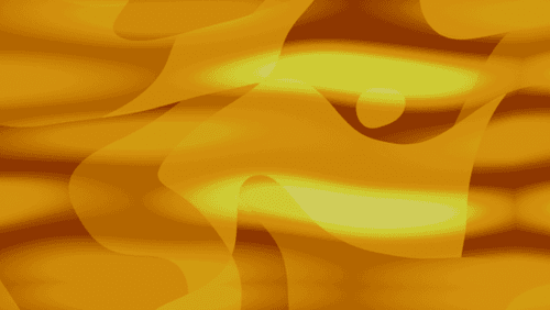

              @Dr-Sassi Now I want to add another object, here a sphere, and let the two textures mix.
              I see various options to 'mix' the textures:
              • animate the transparency of the objects / textures
              • use the proximal shader
              • feather the object. For example the sphere texture is too sharp
              • add transparency in 'areas' of the textures
              Here an example of an extra sphere with an vibrate and transparancy in the texture.
              Here the scene file
              cv4_2025_drs_25_rsoa_02.c4d
              What do you think is th best method to 'mix' the textures and could you give an example?
