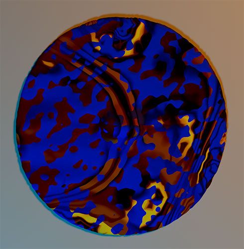

      I started a new thread for my Liquid Acid 'project'.
      I now focus on using Liquids to create the effect.
      I started with the Noseman tutorial and changed to have 2 emitters and thus 2 textures.
      Although the textures are not really mixing, I guess with the right textures it could be improved.
      However I have now an issue that the render is stopped due to "Failed to allocate necessary GPU recyclable memory".
      Here the scene file.

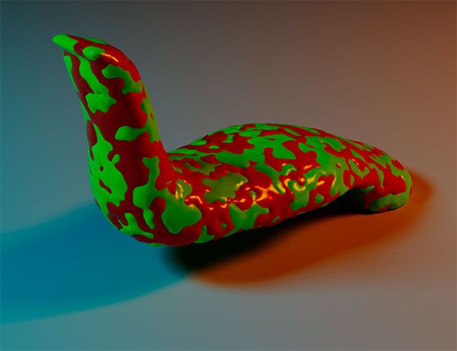

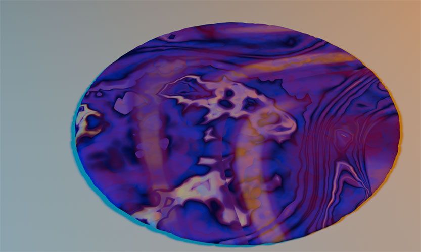

        @Pim Here a second example with 2 emitters and with different settings.
        But I am still not happy with the 'mixing', with the textures.
        Also, the render error is also with this scene file.
        2 emitters v02.c4d
          Thanks for the files, Pim,
          Thanks for the files and for using a new thread!
          Both have the same idea that the Materials should mix. That is not what happened, as the material has no information from the color that the particles inherit to the Surface.
          The mixed color is stored in the Vertex Tag. If the materials are not using that information (Node Vertex Attribute), then they will have no idea about it.
          CV4_2025_drs_25_LImc_01.c4d
          CV4_2025_drs_25_LImc_11.c4d
          There are a few options, use the color of the Particles and with that, the Blend that is on the Surface, or use one Particle Group with black, and the other with white particles, and use that as Mask information. So they mix via Vertex map, and that is the mask between the two materials. (file …_21.c4d)
