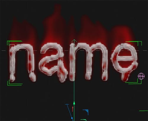

              My current best idea, after even checking Fluids to fill in the Mold, was something more manual, as the problem with all simulations is pretty much, they have their own mind, kind of, i.e., not quickly art directable, which is kind of the target for me, as a similar thing can look great or artificial. Hard to tell upfront.
              Here is my balance between manual and simulation.
              CV4_2026_drs_25_PYnk_11.c4d
              I "drew" the path into the letters, while they start when it gets too hot. In other words, to make sense out of the whole setup, the starting points of each spline should be "touching" the initial word that is on fire, then, with the overall smoke, move to the final letter and fill those. They get their own Simulation System to keep the smoke.
              There are lots of parameters involved. Please allow yourself some time to explore those. I hope the URLs from above have helped already. Let me know if you need more resources.
