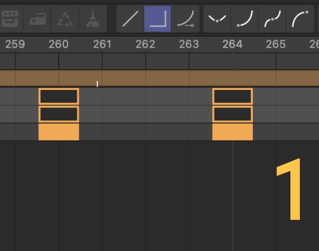

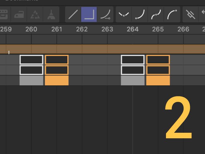

              Option 1
              Go to the Timeline, and there in Keyframe View.
              Select all the Keyframes (see image 1) from the PLA Track
              Now click and hold on one keyframe (all are as before selected) and hold the control command key down, now move all the keyframes (which creates a copy, and move all the new keyframes as a neighbor to the original Keys (see image 2)
              This should give you the stop-motion effect you are after.
