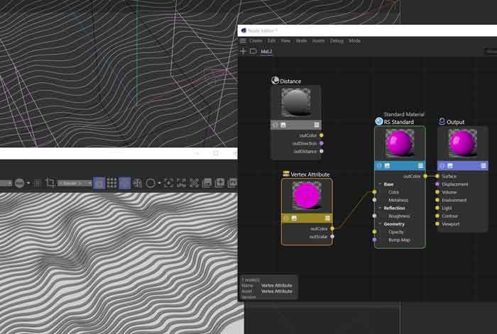

Im trying to shade unmeshed, cloned splines.
I need to have some kind of selection/falloff to be able to drive a blend material and blending between shaders.
The usual suspects (vertex map/fields, distance node) doesnt seem to work on plain splines.
Any idea how to solve that? -

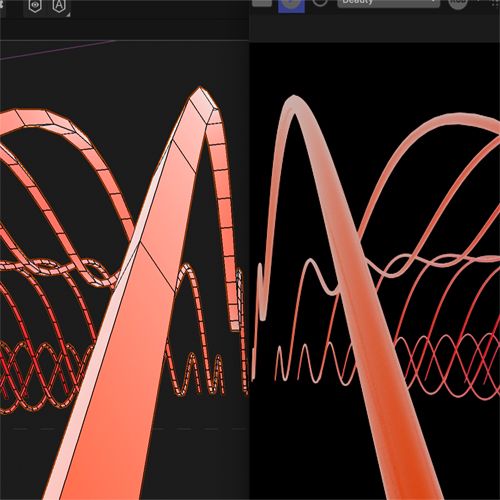

Anyway, please try to minimize the geometry and let Redshift tessellate the results, which might be faster…
https://projectfiles.maxon.net/Cineversity_Forum_Support/2025_PROJECTS_DRS/20250416_CV4_2025_drs_25_RSvc_03.c4d.zip

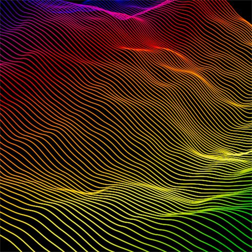

How about this option:
CV4_2025_drs_25_MGwc_01.c4d
