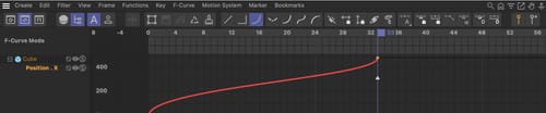

          Here are two screenshots; some icons appear in specific selections (not just the Keyframes).
          See the difference in the Left side selection and the Icons.

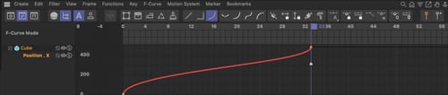

            Just to make sure I'm describing this correctly, I can manipulate the keyframe / handle, it's all those other features (outlined in red) which don't become active, as they should. So, if I quickly highlight a keyframe, and want to zero the handle angle, I'm unable to do so.
