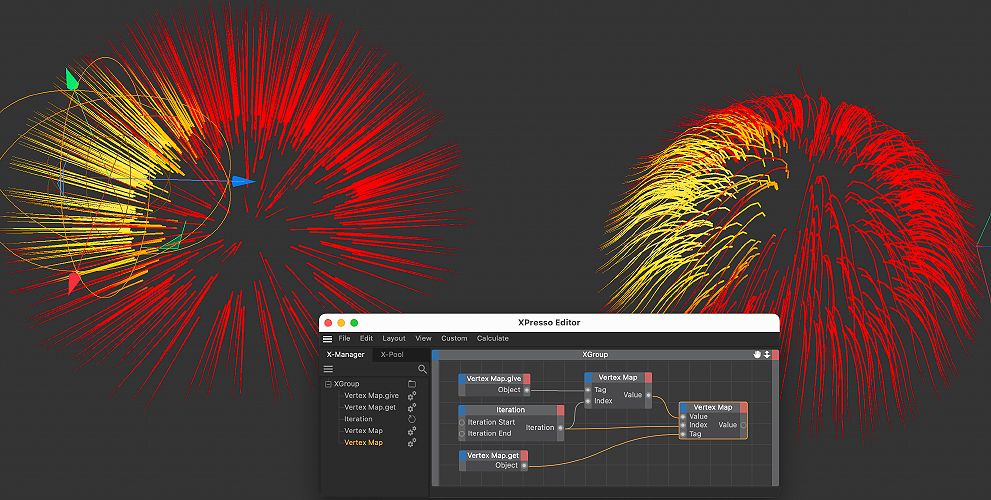

            It requires a static version (Alembic Morph Tag is deleted), and that information is transferred to the other Vertex Tag for simple setups that might work with a Vertex Tag dragged into the receiving Tag. But with Alembic and Hair, I needed to do this via XPresso. See below:
            https://stcineversityprod02.blob.core.windows.net/$web/Cineversity_Forum_Support/2024_PROJECTS_DRS/20240212_CV4_2024_drs_24_RSvh_31.zip
