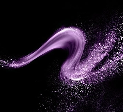

      Hi all,
      Was wondering what would be the best way to recreate the image. A smooth liquid like flow that morphs into particles/glitter. Does anyone know of a tutorial/course or advice on what the best technique would be to tackle this?
      Looks like one sim where the liquid changes as it flows or could be 2 sims?
      Thanks and any help appreciated.

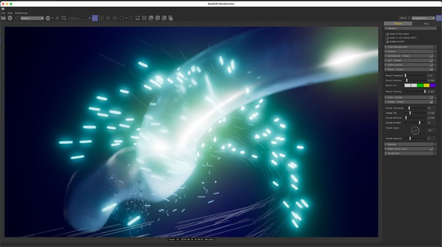

        You did not specify if that is a still or an animation.
        The example below is a collection of techniques, to shape particles and objects.
        I did not try to match the image; I would need more information from you. Perhaps a storyboard?

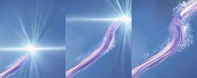

          No problem Dr Sassi, thanks for getting back to us and sending the scenes
          Primarily it would be a still with a view to animating later down the line a bit like the attached. A shooting liquid like flow that has particles flowing out.
            Hi Vi,
            Thank you for the additional information.
            Please have a look at this file:
            CV4_2025_drs_25_PAmx_21.c4d
            This is the basic setup, to shape the fluid and have it (more or less) art-directable. Here, the Rail Spline is an important part of shaping the initial results.
            In the file below, the Volume setup produces the fluid shape. It defines the part on the surface where new particles emerge.
            CV4_2025_drs_25_PAmx_22.c4d
            An alternative would be to take the initial fluid build and have the particles for the next step taken from it. This would reduce the fluid "body".
            CV4_2025_drs_25_PAmx_23.c4d
            I hope the three little examples help to shape your idea. Remember that a second fluid stream (like the first) can be built differently and used to subtract from the first one (inside the Volume setup) to create a more complex fluid body.
